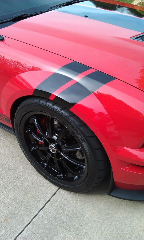

These pics are an install of Vista Blue Metallic fender stripes. Metallic stripes are the hardest to apply so if you can do this you can do any of them! I am using a clear backing tape so I can see the positioning of the stripe and also because I can pull the metallic stripe back to work out air bubbles without deforming the stripe.
First, make sure the fender is clean on all areas where the stripe will be applied.
Make sure you do the underside of the fender where the stripe will roll under and inside the hood opening.
Next make sure you are certain of your stripe placement before you apply. This stripe has arrows to help align the stripe on the fender at the correct angle. To apply this stripe correctly you center the stripes on the rubber hood bumper on the fender and align the arrows on the fender edge by the hood. This will give you the correct angle and placement.
Start applying your fender stripe at the top of the fender. Pull the backing tape off the stripe as you apply it. This will prevent the stripe touching and sticking to the fender as you are trying to work with it. Lay the stripe across the top of the fender and using your thumb, rub back and forth as you set the stripe into position on the fender. Sometimes it helps if you have some liquid lubricant on your thumb to help it slide across the tape. You can lick your thumb or use a spray bottle with a little dawn dish soap to wet the top of the transfer tape if needed. Make sure you do not introduce air bubbles under the stripe as you apply. If you do gently pull the stripe back up to the point where the air bubble are and then reapply.
Apply it all the way to the fender line. When working over corners make sure the stripe lays flat across the entire corner of the fender.
Continue to apply the stripe down the side of the fender rubbing the stripe back and forth with your thumb. Make sure the transfer tape lays flat just like the stripes underneath as this helps with the spacing of the stripes.
Work all the way down to the wheel well fender line making sure that there are no air bubbles and that the transfer tape does not have any wrinkles.
#3 OFFLINE
Posted 12 June 2009 - 07:02 AM
Remove the remaining backing tape.
Cut the backing tape so the two stripes are separated.
Using the same method as described above continue to apply the stripes individually.
Now at the top of the fender cut the transfer tape so you can finish applying the top of the stripes.
Cut both sides of the backing tape next to the stripe so the stripes can be applied individually on each side of the rubber hood bumper.
Fold over and apply the top of the stripes to the top of the fender inside the engine compartment. You will have to work the rear stripe behind the rubber bumper by moving the bumper with your hand and applying it.
#4 OFFLINE
Posted 12 June 2009 - 07:06 AM
Starting at the top remove the backing tape from the stripe being careful not to pull the stripe up.
Start both sides (since they were cut) and eventually you will be pulling the entire backing tape as one piece.
Slowly remove all the backing tape.
Pulling the tape directly back on itself will help from introducing air bubbles.
#5 OFFLINE
Posted 12 June 2009 - 07:07 AM
The final result... STRIPES INSTALLED!!!
In some cases you may have a few air bubbles like this. Do not worry about them. The sun will bake them out and the stripe will lay flat. It is better to let the sun do the work than ruin your stripes trying to make it perfect right away. These normally go away within a day.
Now clean the car.
Installation complete.

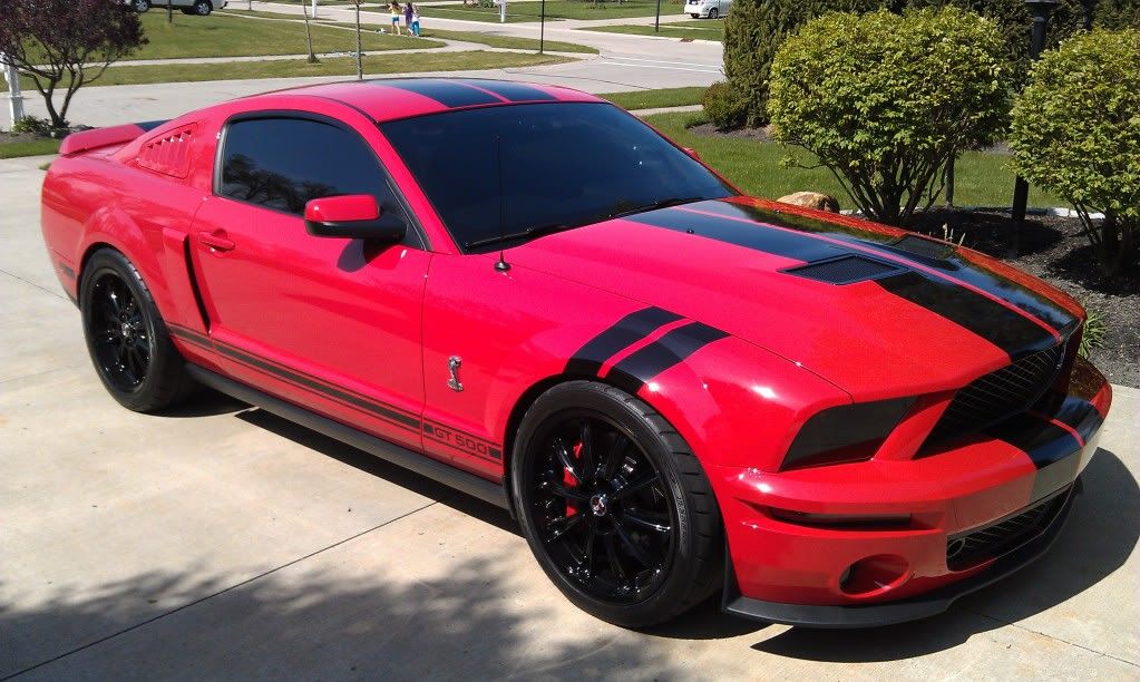

llcwhit, on Jul 19 2009, 08:45 PM, said:
But they do come in very handy when you are trying to pick your car out in a crowd
Whether it is on the track...
IMG_0463.jpg 81.58K
97 downloadsOr at a car show...
DSC00024.JPG 587.35K
112 downloadsMakes it lots easier to find your particular car...
Drive Safe!
