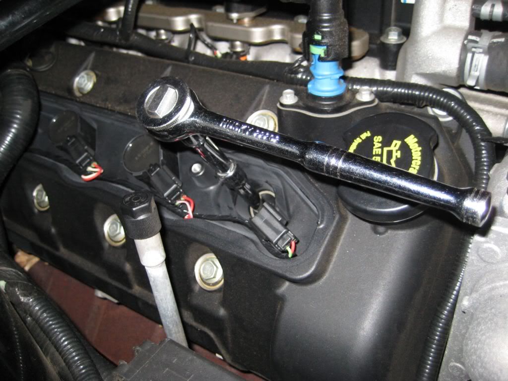

Next, remove the air intake box (don't forget to unplug the sensors and PCV connection) and tube from the throttle body. Then remove the gray coil pack covers- the stock ones say "Powered By SVT:"
Each cover has two fasteners. 3 fasteners use a Torx T-30 bit:
Depending on your engine, the fastener closest to the passenger with the wire loom on it (just pull the wire loom up and away from the cover) either uses a 10mm deep socket or has what looks like a torx bit on the end:
Mine has the torx-style fastener as show above. Use a 4mm socket on it:
Lift off the coil pack cover. It is sealed by a reusable rubber gasket. This is what's under it- coil packs and their wiring:
