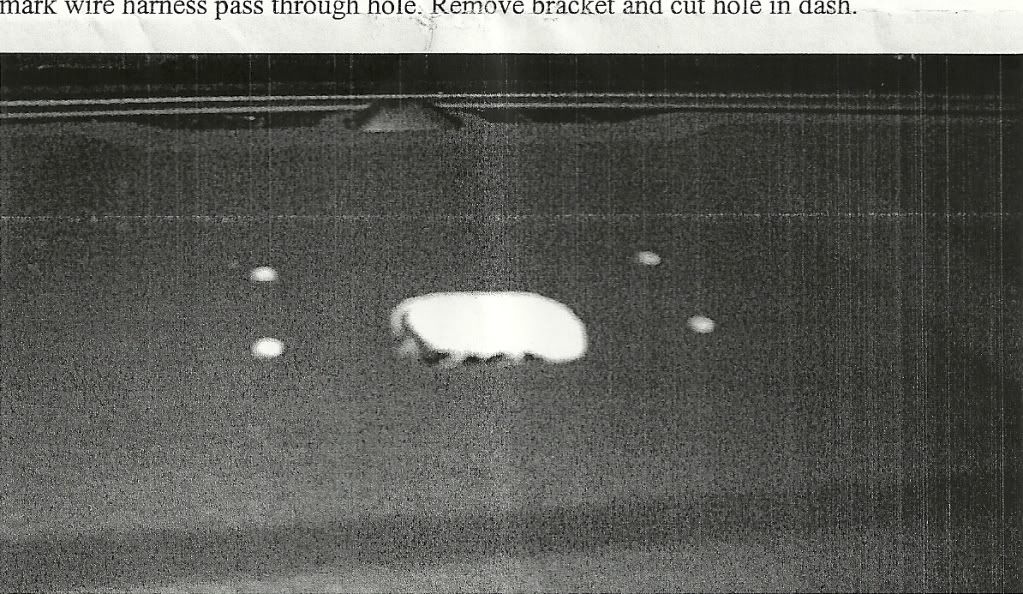

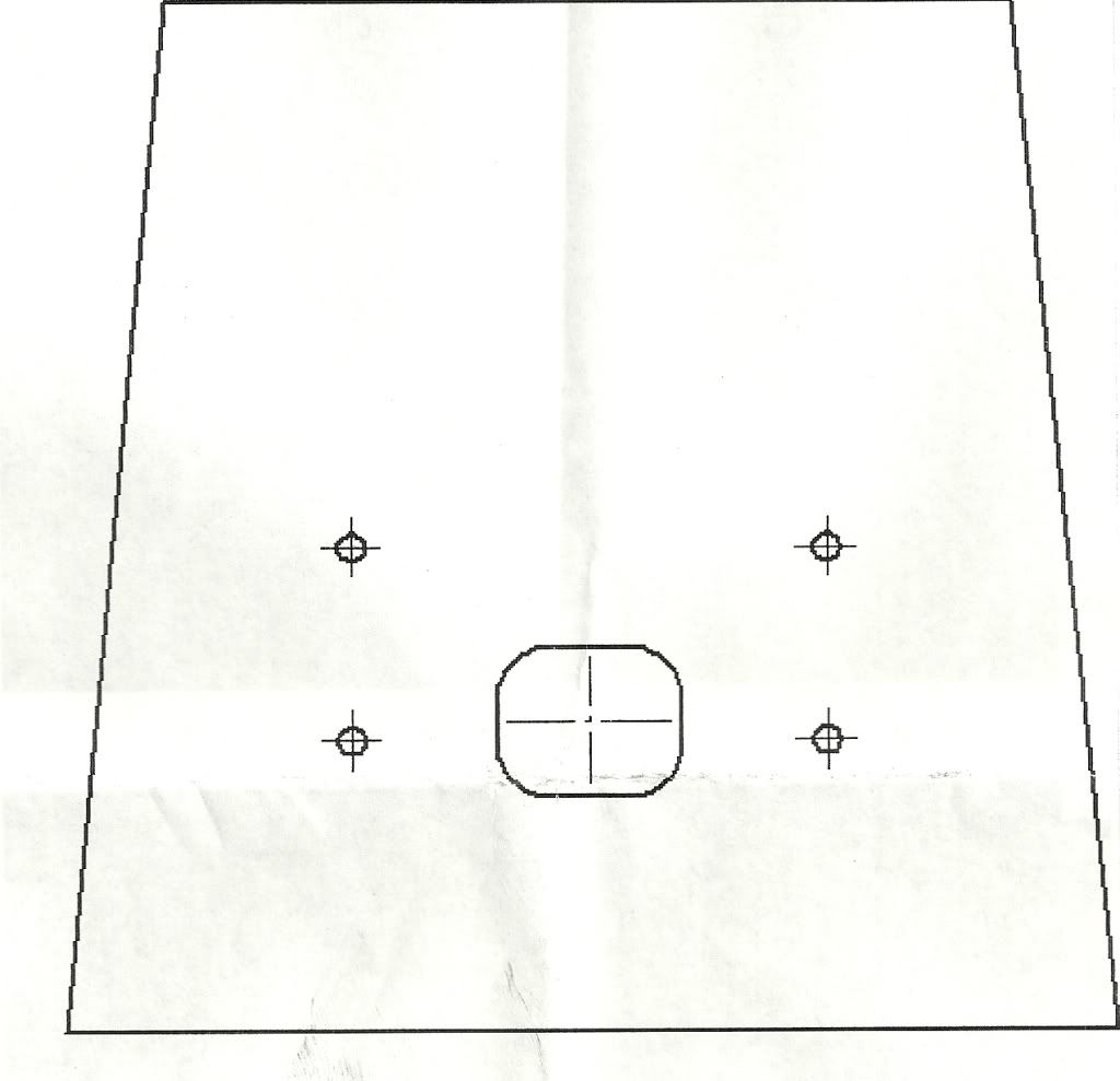

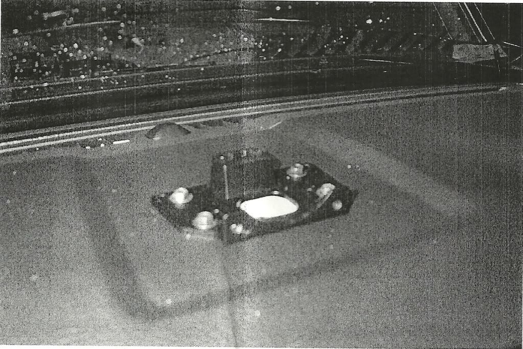

Have no idea how it's affixed to the dash - by adhesive or screws. If it requires drilling a hole, I'm going to make damn sure I use a hole size I can cover with a rubber plug - if I ever want to remove them.
Someone suggested double sided tape. I found a roll at my local Ford dealer, cheap (same stuff used on the Ford Motor Co. side scoops and the Shelby quarter window scoops, with red protective tape).
If I use the pod, I will double tape it. I REFUSE to cut holes in my dashpad just for a gauge pod.

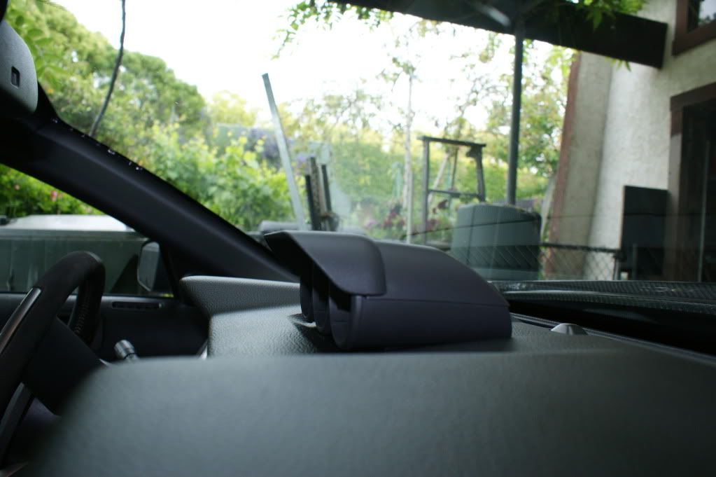

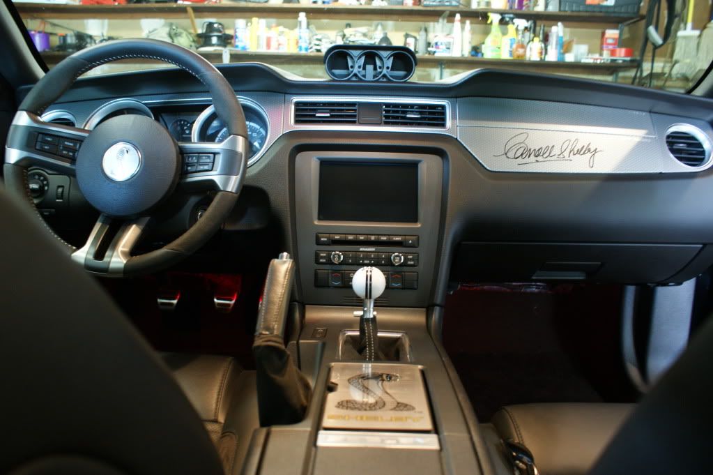

Looks good mounted, I wish the Shelby had it as an option...

Is it just me or is there a recess in the dash where that pod sits? Is that present on all '10+?

Yes, both my 10' & 11' have an indent in the dash where this would sit.

In an earlier post, I suggested double-sided tape to mount it, as I refuse to put a hole in my dash to screw it down. Has anyone actually ordered the pod housing yet? I'd be curious to know if the instructions from Ford tell you to screw it to the dash......

For installation, I've looked at several pictures of Boss LS models on eBay and have a good idea how to replicate dash placement. Unfortunately, no pics showed a view of the backside of the gauge. I was hoping to see the routing of the wiring to the gauge pod. I'm assuming Ford brings the wiring up through the dash directly under the pod and that the pod is also screwed to the dash.
:wacko:
I've already been under the dash on my car and it is possible to feed the wiring into the side of the defroster manifold (through the foam expansion joint between the defroster manifold and the main air box), snake it up and out the defroster openings on the dash and then make a short, straight run into the back of the pod. I will mount the pod with with DS tape. No screws/holes for me......
What would help me a bunch is if someone with access to a LS Boss could take some pictures of the BACK of the gauge pod, possibly by taking a pic through the windshield or by holding a camera over the pod and shooting downward, so that I can see if the wiring comes up through the ductwork from the factory (I doubt it) or if the wiring is invisible from behind the pod (more likely) becvause it's drilled/wired from underneath. If by some miracle the wiring is exposed as-installed from the factory, any pictures of how it is done would be really helpful.

Alright folks....just received the dash pod today and per the directions you would have to drill your dash to run the wires. Otherwise you would have to run the wires to the vent exposed on the top of the dash which would look pretty cheesy. Probably going to abandon this idea unless there are some creative thinkers out there that can come up with a work around that looks nice. Thoughts?
Posted Image
Posted Image
Posted Image
Photos from directions (4 small holes and one larger one):
Posted Image
Posted Image
Edited by scpinto, 14 May 2011 - 04:50 PM.

guys ford had to put holes in the dash to install the pod correctly, so if you decide to install it ,in order to do it right you need to drill holes ,the pod looks great in the boss LS why worry about the holes , why would you take it off once its installed , most of the installs are for looks anyway the car has enough gauges from factory ,so most likley if you or myself install this pod its not comming off imo

Only ordered the pod so no idea about the complete kit with gauges. The included cutting template shows (4) 1/8" holes for the mounting screws and the wiring hole is about 1" in diameter. I guess the holes are not a big deal if you are going to keep it installed. I just like to be able to return to stock if I so desire. Once this is done.....it's done.
Posted Image

When mine arrives, I plan to alter the template to hopefully be consistent with some ready-made rubber plugs I could use, if necessary to at least cover the holes if I want to remove it in the future.
