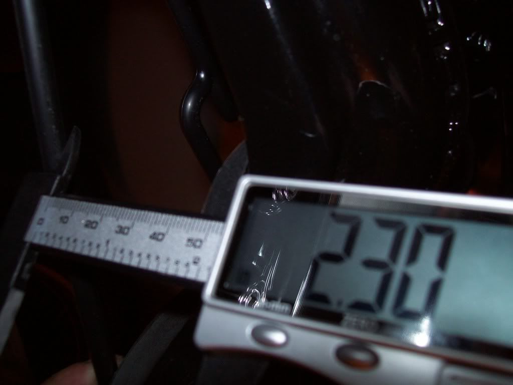

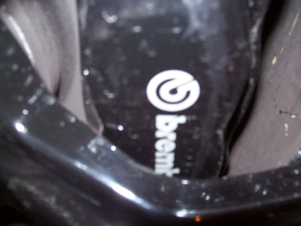

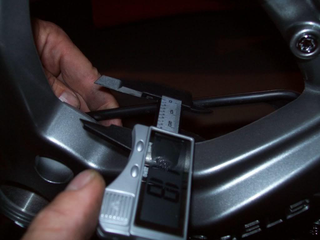

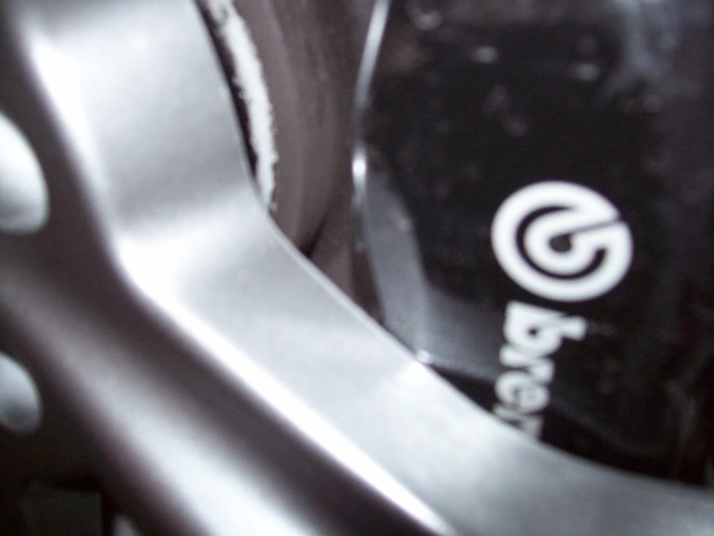

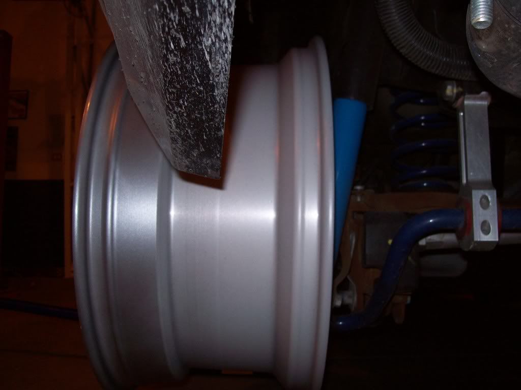

Ok, results are in!  Well, our logic isn't fouled, but the results......as stated, the only way that these wheels would not work with big brakes is that the wheel would have to be designed completely different.  Guess what...the wheel is designed completely different.  These wheels will NOT work with big brakes or GT500 Brembo's.  As soon as I opened the box, I was able to notice that the center section of the wheel was not near as arched as mine.  The spokes are not arched out in the center like my +24's.  However, the 20x10's are going to be awsome for the back.  The are built perfectly to stuff as much tire as possible under there and fit.  The 20x9's +30 and 20x10's +48 would be and awsome combo on a GT with out big brakes.  See pictures below for the design difference:
Spoke on 20x9's +24:
Spoke on 20x10's +48
20x9's fitment around Brembo's
20x10's, no way in heck!
20x10's on the back, awsomness!
20x9's +24 Space from hub surface to center of spoke arch, 2.3":
20x10's +48 Space from hub surface to center of spoke arch, 1.2" wow, huge difference.
