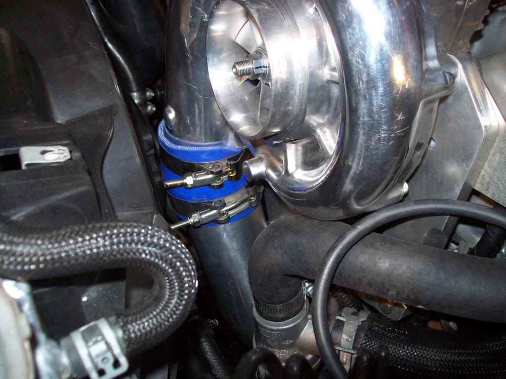

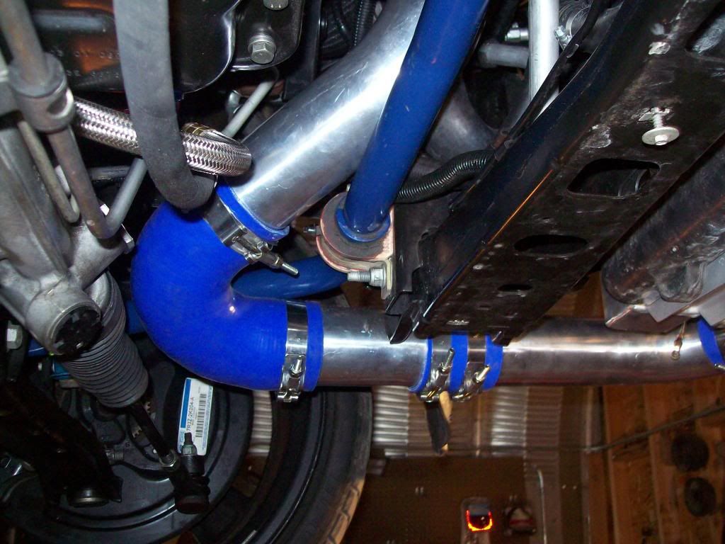

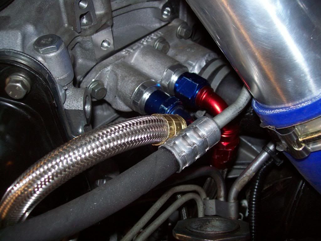

Ok, it's been a long time but I finally spent some quality time with the car.  It's running, but yet to be tuned.  Now time to put some miles on it for engine break in then back to get the power tune done.  The intercooler took much more modification then I was planning.  Only way to get the drivers side tube from the supercharger down and around the sway bar was to move the oil filter, by remote mounting it to the rear of the motor on the drivers side of the engine.  It took some creative tubing work, but seems to be working great.
