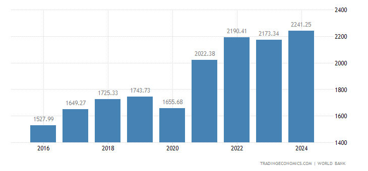

So then we are helping the Canadian economy?
For sure as you can see by the chart there has been steady growth in the Canadian economy since the relaease of the GT500. A little blip when they released the ugly but 2010 LOL.
