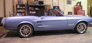

The removal of the KB parts is almost done. Waiting on the fittings for the rear axle cover to install the oil cooler lines, an alignment and it will be done. As you may notice the stock K member is back in the car, but it is hard to see from this picture. The ARH 1 7/8" LT headers and X pipe are in, along with the Borla 2.75" mandrel bent over axle pipes and Corsa mufflers. PAS posted a picture to their Facebook page with them test fitting a Cortex Racing SLA K member. This was a test fit for header clearance on the GT500s with different mounting heights of the engine for blower to hood clearances and header to K member clearances. Cortex doesn't make a lower control arm that works with the stock spindle and strut assembly and their K member at this time. Since my car had the K member out of it, PAS and CorteX used it to see what possible problems could arise with the SLA K member for CorteX GT500 customers in the future. None were found with the engine being able to be lowered for blower clearance with this parts combo.

Looking good! Interesting to hear how it handles and compares

I'm hoping to pick the car up late Saturday afternoon if I can find the time.
